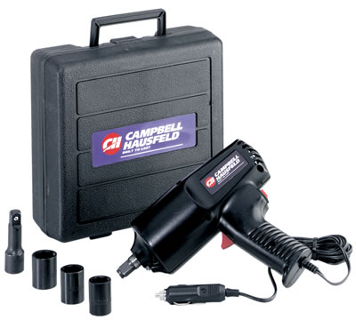

    I think you need to read this thread:
    http://www.elantraxd.com/forums/show...8&page=1&pp=20
    and go buy one of these:

    Isn't it recommended to not use an impact gun when tightening your lugs?

    Considering that i've broken so many lug nuts using conventional tools that I forgot how many... I have been using the electric impact wrench for over a year and i have had NO BROKEN LUGS !
    OHH YEAH !

    Hmm... maybe the electric impact wrench has just about enough ummmph to do the job. I know the bastards at Costco can take the lug nuts off with their air impact wrench but when putting the wheels back on and torquing the lug nuts, their policy is to do it as much by hand first and finish with a torque wrench. I hardly see any of them do this though.

    yeah my roomate has a 4 spoke wrench and thats what i snapped it with. it was only turning so far so then we both torqued it and it snapped. it was also like 30 degrees outside so i was in a rush to change the tire. i'll take it to tally hyundai tommorow and see what's up. i also have a fog light that just went out. is that warrenty too.?
    also http://store.yahoo.com/dynadirect/sp-rl1002.html samething but cheaper ford

    WOW ! thats the same one I bought and is only $29 !!
    I paid $49 for mine damn !
