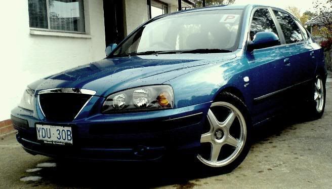

...and a little bit of Photoshop Magic! (blacked out the grill and turned up the contrast)
2005 Hyundai Elantra FX aus spec
Mod List:_________________________________
2" PSC Catback Exhaust
K&N Panel Filter + Modified OEM intake
17" wheels + 215/45/17 rubber
Painted Brake Calipers with decals
20mm PSC Rear Sway Bar with Metal Endlinks
Pedders Sports Rider springs (30mm drop)
2 x 12" Audiobahn Subs - 400W RMS each
800W RMS Class D Amplifier
1 Farah Capacitor
JVC Head unit + ipod adaptor + 15Gb ipod
OEM Tiburon Pedals
Custom Grill with mesh insert
OEM Dashmat + OEM Floormats
Clutch Slave Cylinder Mod
TB Coolant Bypass Mod
35% Tint allround
Cosmo Racing Shortshifter
100sq ft of Fatmat (Dynamat)

Very nice and clean. I love the caliper job! But I can't imagine shifting with my left hand. Must feel wierd to Americans.
The only problem I have with your car is your choice of route for the amp wire. It's not good to run it through there because you run the risk of pinching the wire. Not only that, but as that wire gets wet from weather, the insulation starts to turn yellow/brown and gets weak. What you can do is get a Unibit from Home Depot and drill a 3/4" hole behind the black padding near your passenger side strut tower. Slap a grommet in the hole and snake your wire through there.
Other than that, keep it clean! ;)

Nice ride mate. :D
Love the rims and calipers, looks great!
The clear indicators and alloy pedals look good too.
Did you also get the alloy deadpedal?
Is the cat-back from PSC?
How does it sound compared to stock?

I love the car mate, looks real good. I happen to have the same style as you, and I really like how those rims look on your car. It was a shock to see it RHD, however, but then I remembered you are in Australia. That would be a blast to drive.
