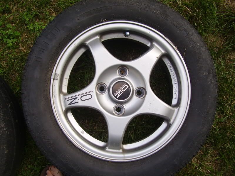

maybe if you keep the stock brakets But I am not sure if they will bolt on to them, I believe the 02 xg350 set up fits the GT alloy wheels it will not fit the steelies, best 15" rim upgrade for this cars are the Lancer O.Z wheels.
