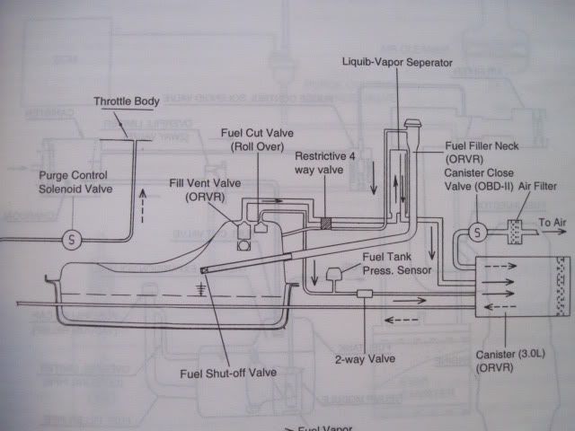

I have a 2003 hyundai elantra gls and every time a try to fill up tank it triggers the nozzle at the pump and it would take from 5 to 10 minutes to fill up tank. Any ideas please???????

CHARCOAL CANISTE EXPLODED!!! PLEASE SEARCH!!! sorry but this is literally the 4th time i have answered this in the past couple of weeks.

sorry.....i'll do one better...
here are the diagrams! and a pic of where the canister is located. 2 12mm nuts hold the plastic cover on. there are a couple of hoses that you will need to clean out and probably have to replace the canister close valve. sorry so hasty...
for whatever reason...failbucket is flipping it at the site but the linked pic is not flipped...sorry.
