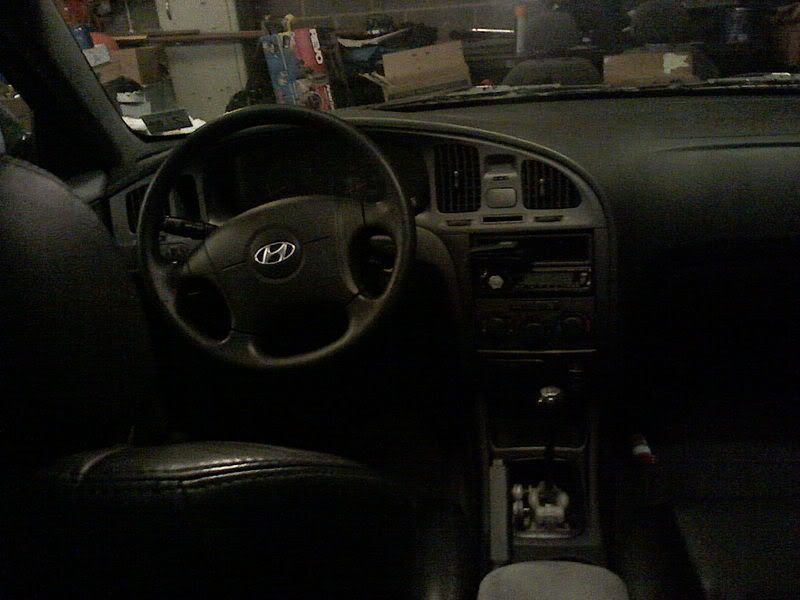

Got the refirb starter and installed it. Jumped the correct wires and it LIVES !
pics of interior??
pics of interior??
sure but......why?
just to prove that you now have a 5sp...who knows
2
pics are from my camera phone in my dark garage, sorry for pic quality
interior
engine
