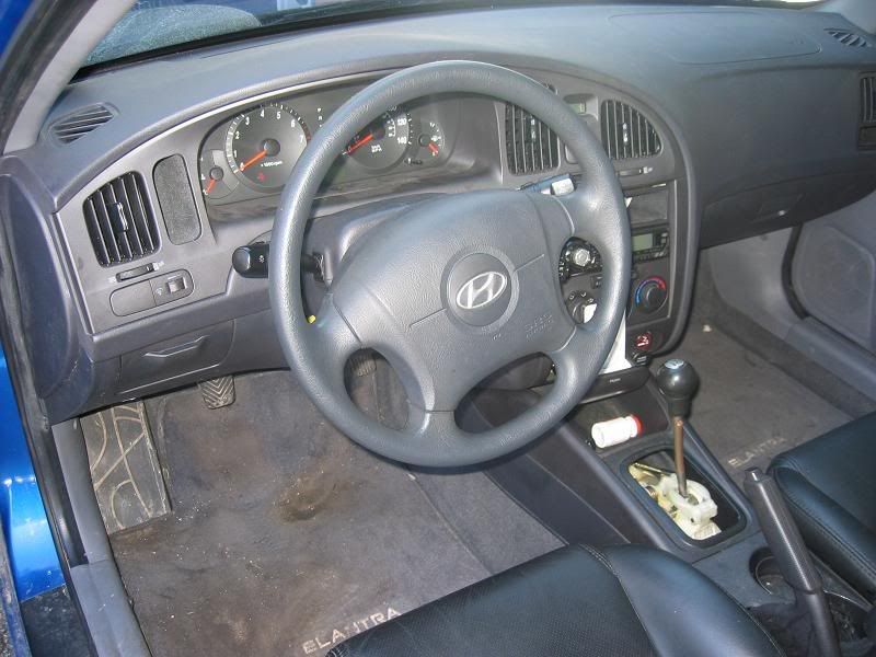

ok, here are some random pictures from the swap
car needs a wash
the shop I work in
my lift, toolbox, surround sound system and all my other crap
