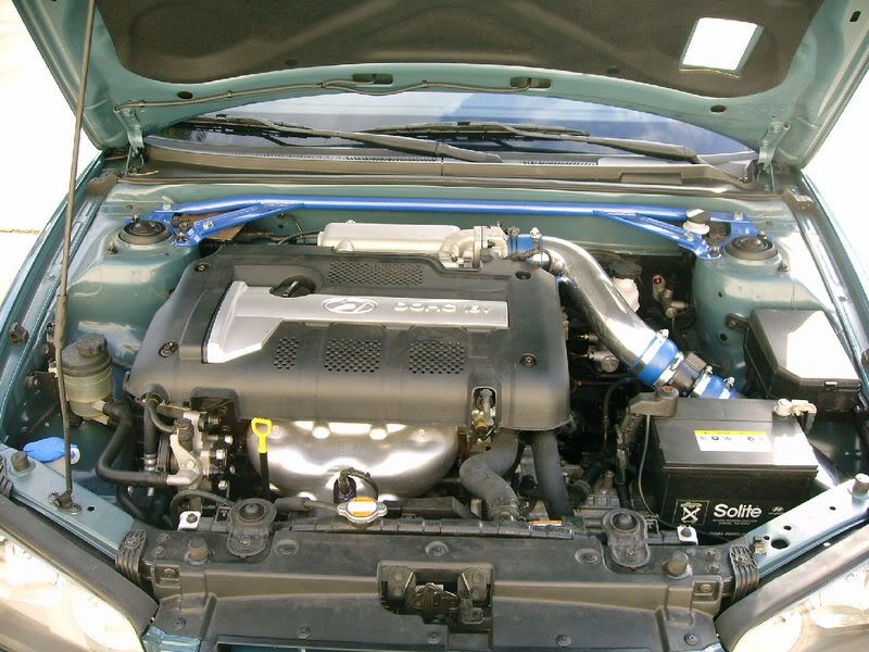

I concur.... DC Sports is the one.
I have a Kia Spectra front strut bar right now. The Elantra doesn't have as much clearance under the hood as the Spectra so the bar doesn't quite fit. It needs to be mounted differently which makes it actually touch the intake manifold sometimes when backing up. I plan to get a DC Sports bar at some point.
The KDM Tiburon OEM bar is also great!
Forget those Evofusion ones... Crap :mad:
do you happen to have a picture of the KDM Tiburon OEM bar?
The disadvantage of that bar is that you have to remount the cruise control module to get that one to fit. With the DC Sports bar, depending on tolerances, you may have to slight "tweak" the location of the CC (by bending the bracket just a little), or just leave it as is.
