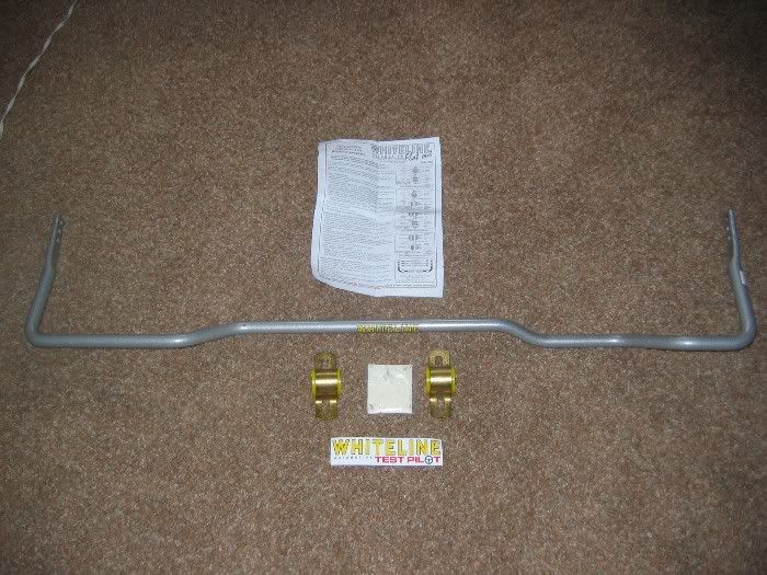

dont sleep on the whiteline adjustable bar...the part number is BHR57Z and can be had for 225 usd from
www.globalperformanceparts.com <this is whitelines US dist. :D
www.whiteline.com.au
adjustable from 18mm to 22mm....
