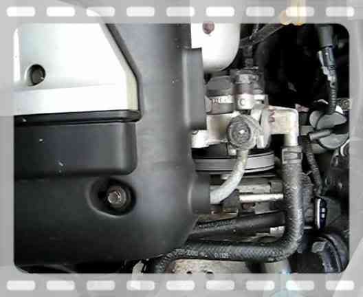

Whats up guys? Long time no post. I have been trying to check back every once in a while and now that i have a data plan on my phone makes it a bit easier. ANYWAY I have a wierd noise coming from the belt side of my engine. I have a youtube video. listen for the background noise. Any help appreciated
http://www.youtube.com/watch?v=PNPxHEOuc70

Is that supercharged. My uncles truck whined like that because of the Alternator. He put a brand new one in and it did the same thing. Probably a bad bearing in the PS or the Alternator. As stated check your fluids first.

Might be a bad alternator. Put the lights the fan and every other electrical thing on. If it does get louder I would start there.

HAve you checked belt tension? Have you physically looked at the belts to verify their condition?

ive got the same noise on the second vid. my water pump HAS NOT been replaced yet and im at 105k so im begining to wonder if thats it.....i havn't had a chance to really check into it with a steathescope but i think ill do that next weekend..... then again ive heard alternator bearings take a dump and sound like this on a few diffrent cars.

Removing belt driven accessories' drive belts is THE way to find out which one(s) are making noises. While the belts are off you can rotate the pullies manually, and this is also very informative. All the bearings should spin quietly by hand, and there should be *no* roughness to them at all.
